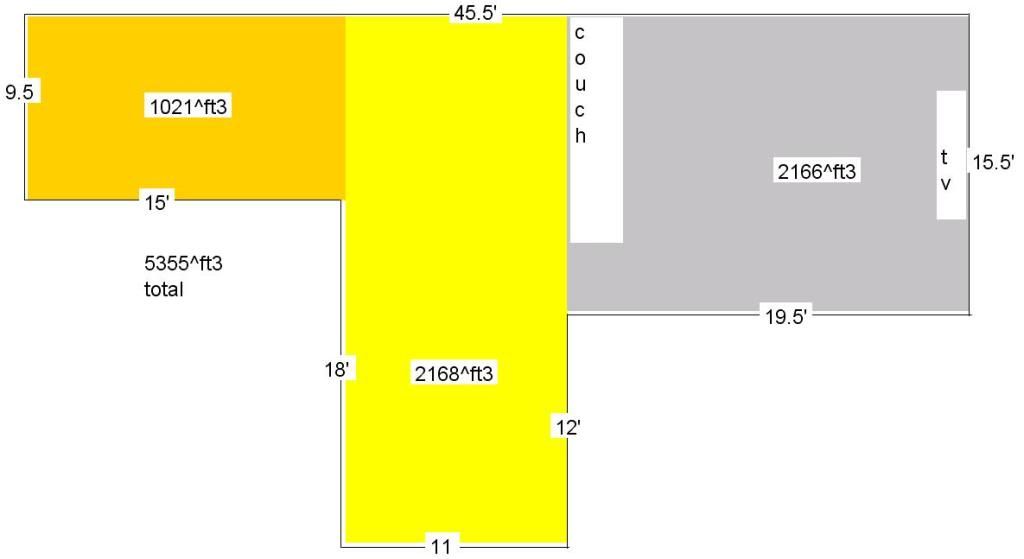

Ok, my setup.
60" plasma
Denon AVR 1611 (75wx7)
Polk M10 (ceiling mounted about 1' off wall) I'll most likely move these to the rears eventually but using them for now.
Basement is big and open, but "theater" area is 2166^ft3 (grey).
Have large open areas behind "theater" area totaling 3189^ft3 (orange and yellow)
Here is footprint of basement. The colors just show the cubic feet, there are no internal walls separating them.
Here is pic from back of the couch.
Priority 1 is Sub for HT 90% (10% music). Thinking $600 range. Most likely HSU.
I'm NOT a basshead. I have a kid and one on the way. I just want it to sound good. Could I go less than a VTF-2 MK 4?
Recommendations are appreciated.
I basically want to know if the VTF-2 MK 4 will sound good in this set up or not. Do I need to step up? Basically I don't want to drop $600 if it doesn't sound great. Keep in mind, I don't want a shake down the house sub either.
So....what would you recommend?
Also, where would you place the sub in this case?
TIA.

Hi mfer,
Great looking room you have there, thank you for sharing!
You have a large overall volume of space to fill, so I would suggest going with a 12" subwoofer at a minimum. VTF-2 MK4 is certainly a good choice, and if budget is flexible, you can even consider VTF-3 MK4.
How much flexibility do you have in terms of placing the subwoofer? In general, it is best to place the subwoofer as far away from those large openings as possible.

I'm flexible with the sub placement. This would be the first Sub I ever bought so thanks for the help.
Which would fill the space better?
2x VTF-2 MK4
or
2x VTF-3 MK4
or
1x VTF-15H
Please keep in mind, I don't want to shake the house. Just want good, clean sounds.

All those models will fill the space nicely. Given your space and your listening preferences, and given that you have a large L-shaped couch, I would probably lean towards getting dual 12" subs in order to get the smoothest bass across multiple seats.

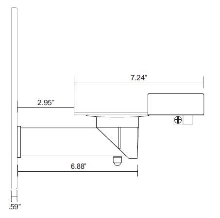

You recommend using the Pinpoint AM-40's. Here is the side layout of them.
I don't see how I'll get anywhere near 21" off that back wall using these mounts. Looks more like I'll only get about 4" off. I'm also not sure I can get them low enough to the ground because of the fireplace as well and I see you suggested turning them up-side-down to get the tweeter horn closer to the ear than the woofer.
So, I guess the question I'm asking is, how do you recommend setting up HB-1's in the front?

Any chance that you can place a pair of HB-1 MK2 on speaker stands (with tweeter close to your ear level when sitting down), located to the immediate left and right hand side of the TV?
Note that the HB-1 MK2 needs a minimum of 1-2 inches of space behind the speaker. So a side-clamping wall mount is acceptable. But for critical 2-channel listening, it is nice to be able to put them on stands and pull them away from side and back walls in order to reduce the amount of reflected sound energy.
